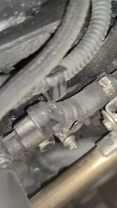

    But back to my question, here you can hear some "ratteling" sounds, engine runs very hard and sounds like old 800tkm driven toyota hiace.
    Where is this ratteling sound coming? It comes somewhere close to injectors. There are no lose bolts, also dont worry about rail pressure sensor wires, they are fixxed now.
    When car is idle, it runs very bad and hard and ratteling. When I press gas, even littlebit, it smooths out, ratteling stops and it does not shake anymore.
    Good example here is when In park, my friend comes next to me. I have to shut down then engine because We cannot hear each other, the idle engine sound is so loud.
