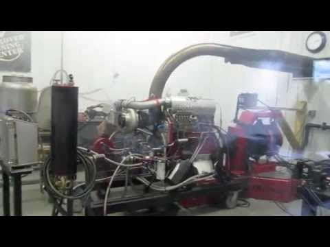

Engine DYNO FAIL. Built Turbocharged Cummins 5.9, Entire Intake manifold Blows OffYou can watch the pressure build in the pipe before the inevitable.www.youtube.com
